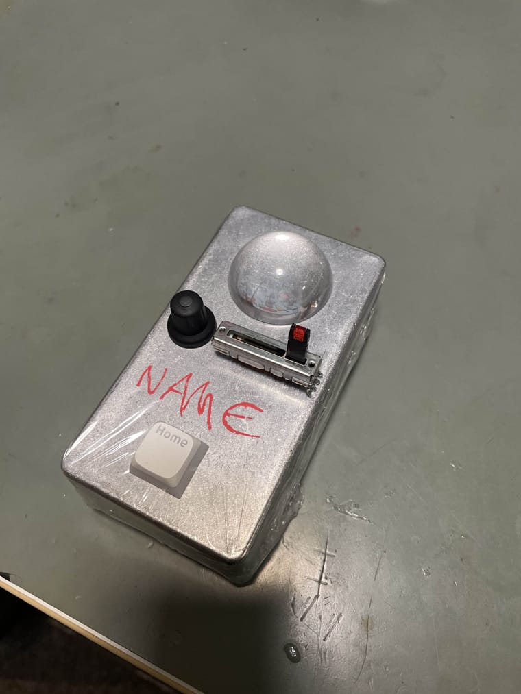

  • Hardware Design
    Yeah I think the large size of the dome will actually make it easier to engineer something to hold it.
     Lua Pedal

  • Hardware Design
    Just adding Simon's "prototype". 😆
     Lua Pedal
